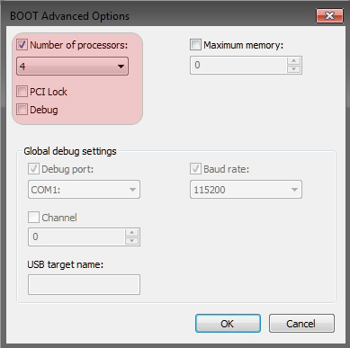

Change the Number of Processors Used at Boot Up
Information:
If you have a multiple core CPU (e.g. Intel Core Duo or Quad CPU) or multiple CPUs, then this will show you how to change the Number of Processors that will be used during boot up for troubleshooting and debugging purposes to be able to determine if there is a problem with a single processor/core, or for a programmer to test their code against a single core while running on their multi-core system.
Note:
Windows 7 will use all your processors by default at boot up without this Number of Processors setting box checked. Using all of your available processors (cores or CPUs) during boot allows the computer to boot faster only because a multiple core CPU or multiple CPUs can handle and do more at once than a single core or CPU. Multiple cores do not actually increase the speed, but only increase the number of processor cores working on the job which in turn has the job finish quicker. If you do not have much running at startup, then you may not notice much improvement in how long it takes to startup.
Instructions:
Click the Advanced Options button. The Boot Advanced Options Window will then pop up.
Tick the check box saying Number of Processors. Now click on the drop down box and select the maximum number of processor cores (might be 2 or more).
[* According to some sources this setting doesn't speed up boot time]

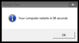

How to See What Your Windows 7 Restart Time is
Information:
This app will show you how long in seconds it takes your Windows 7 to restart back to the desktop.
See the instruction and download the app HERE

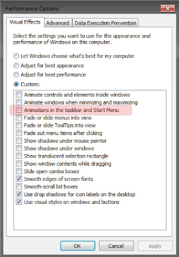

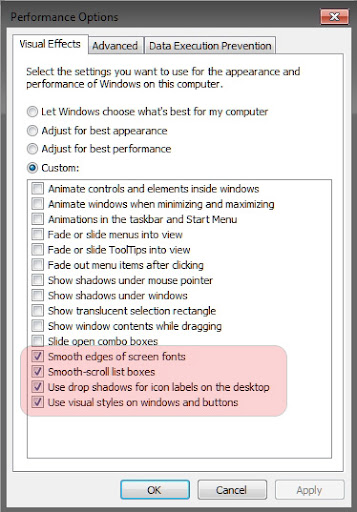

Disable the Unwanted Visual Effects
For this right click on Computer and select Properties from the right click menu.
Click on Advanced System Settings from the left pane to open up the System Properties window.
Select the Advanced tab from it. Then Under Performance click Settings . Choose Custom: Options From it.
Now untick all the options and select only the last four options
Now just logoff your system and turn logon.

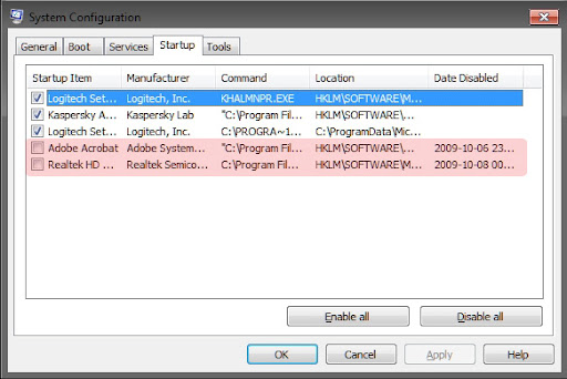

Disable Unwanted Startup Programs
Many programs have components that start when Windows starts and run in the background. While some of these programs are necessary (such as antispyware programs), you will find that others may not be necessary.
Press [Win] + R or take the RUN option from the start menu.
Now type msconfig in there and press Enter Key to open up the System Configuration Window.
In the System Configuration window, the Startup tab shows all the programs that are scheduled to start with Windows. Resize the columns so that you have a good view of the name and manufacturer.
Go through each item, clearing the check box for programs you don’t want to start with Windows.
Click OK, and then restart the computer.

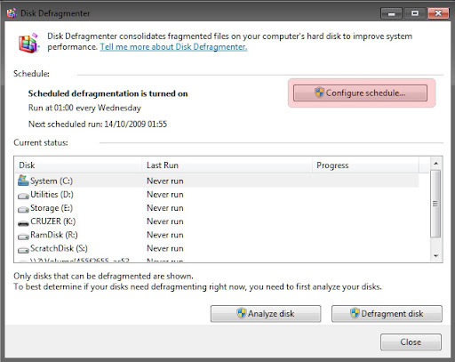

Disk Defragmenter

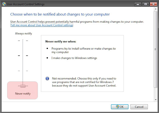

Disable the User account control (UAC) Feature
From the Control Panel open the User Accounts and Family Safety
Click User Account.
Click the User Account Control settings link.
Now just Drag the Slider towards Never Notify.
Click OK and Reboot your system.

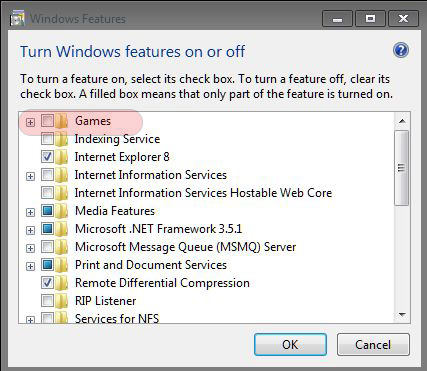

Turn off Unused Windows 7 Features
There are many feature in windows 7 that we often don't use.
Disabling these unused features in Windows 7 will really help in speeding things up.
Open up Programs and Features from Control Panel.
Click the Turn Windows features on or off from the left pane.
Now uncheck all the Feature that you don't use in Windows 7 [e.g. "Games"] and restart the system for the changes to take effect.

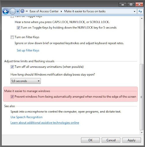

Disable the Aero Snap features in Windows 7
Information:
Aero Snap will help you to maximize, minimize and resize the windows just by dragging and dropping it into the screen corners.
Instructions:
Open the Control Panel and double-click on Ease of Access Center icon.
Now click on the Make it easier to focus on tasks seen at the bottom in there
Now tick the check box saying Prevent windows from being automatically arranged when moved to the edge of the screen.
Note: After you disable Aero Snap Feature, you won't be able to use some of the new Windows 7 keyboard shortcuts used to move the active window around the screen, e.g. Win+Left Arrow, Win+Shift+Right Arrrow, etc. See the "Windows 7 Keyboard Shortcut List" section below for more useful shortcuts.

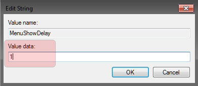

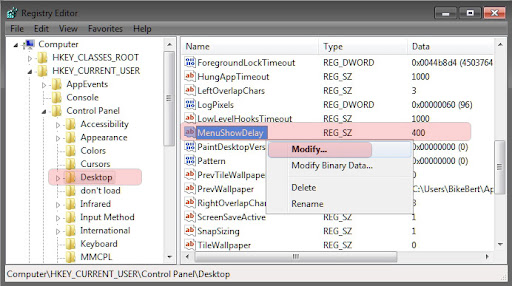

Speed up the Menu Show Delay Time
Information: This will show you how to change the amount of time it takes for a menu in Windows 7 to pop, fade, or slide open when you run the mouse pointer over it.
Instructions:
Now type regedit there and press Enter Key to open up the Registry Editor Window.
In regedit go to HKEY_CURRENT_USER\Control Panel\Desktop
In the right pane, right click on MenuShowDelay and click on Modify
Type in a number between 0 to 4000 [400 is default, I use 1] for how many milliseconds you want the Menu to wait before it opens.
Log off and log on, or restart the computer to apply the changes.

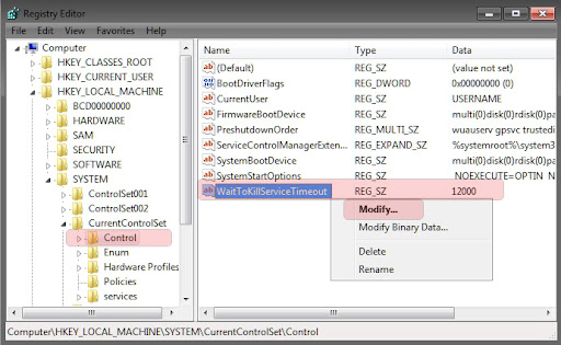

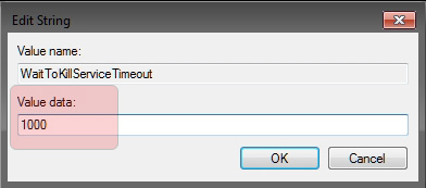

Speed Up the Shut Down Time
Information: This will show you how to set the "Wait to Kill" time Windows 7 waits for programs to save data and close before shutting down.
Instructions:
In regedit go to HKEY_LOCAL_MACHINE\SYSTEM\CurrentControlSet\Contro l
In the right pane, right click on WaitToKillServiceTimeout and click on Modify
Type in a number between 1000 to 20000 [1-20 seconds] [12000 is default, I use 1000].
Note: If you have problems with programs from your computer shutting down to quickly, then repeat the above steps and increase the time a bit.

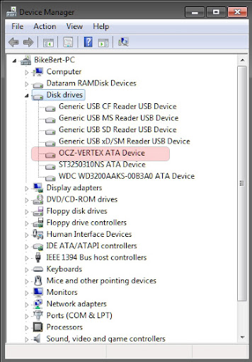

Change from IDE to AHCI Mode after Installation
Information: AHCI stand for Advance Host Controller Interface. AHCI is a hardware mechanism that allows software to communicate with Serial ATA (SATA) devices (such as host bus adapters) that are designed to offer features not offered by Parallel ATA (PATA) controllers, such as:
Hot-Plugging
Native Command Queuing (NCQ) -might improve computer/system/hard disk responsiveness, especially in multi-tasking environment
You can read more about AHCI mode HERE
Instruction: There is one way to fix this, although you need to have knowledge of registry editing.
The detailed steps from Microsoft website are as follows:
Exit all Windows-based programs.
If you receive the User Account Control dialog box, click Continue.
Locate and then click the following registry subkey:
HKEY_LOCAL_MACHINE\System\CurrentControlSet\Servic es\msahci
In the right pane, right-click Start in the Name column, and then click Modify.
In the Value data box, type 0 [3 is default], and then click OK.
On the File menu, click Exit to close Registry Editor.
Restart your computer
Go to BIOS and enable AHCI, Save & Reboot
Another restart will be required to finish the driver installation.
Alternatively
Just download this Reg File and double-click to implement AHCI on your Windows-based computer.
Just remember to do the BIOS switch as well when you reboot.

Enable Write Caching
Description: This will show you how to enable write caching to have better performance for a storage device.
Instructions: Open the Control Panel -> System and Security -> Device Manager -> expand Disk drives -> Double click on the listed storage device that you want to enable write caching for -> Click on the Polices tab -> By default, "Enable write caching on the device" is checked under the Write-caching policy section. If not, then check it -> Select (check) the "Turn off Windows write-cache buffer flushing on the device" box -> Click on OK -> Click on Yes to restart the computer to apply.
WARNING: Turning off "Windows Write-cache Buffer Flushing on the Device" runs the risk of data loss in case of a power failure without actually shutting down the machine.

Disable defragmentation
Description: Defragmenting a hard disk's used space is only useful on mechanical disks with multi-millisecond latencies. Free-space defragmentation may be useful to SSDs, but this feature is not available in the default Windows Defragmenter.
Instructions: Start Menu -> Right-Click Computer -> Manage -> Services and Applications -> Services - > Right-Click Disk Defragmenter -> Startup type: Disabled -> OK
Turn Off the Disk Defragmenter Schedule
Description: Disk Defragmenter schedule allows to run defragmentation automatically in Windows 7. Disk Defragmenter is set to run on a automatic schedule by default in Windows 7.
Instructions: Start Menu -> All Programs -> Accessories -> System Tools -> Disk Defragmenter -> Click on the Configure schedule button -> Uncheck the Run on a Schedule box -> Click on OK -> Close the window.

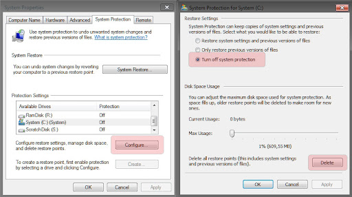

Disable System Restore
Description: Don't write backup copies of files when installing new programs or making system changes. Can free up between a few hundred MB to a couple GB.
WARNING: Although unlikely, if a driver installation corrupts your system, there won't be an automatic way to recover.
Instructions: Start Menu -> Right-Click Computer -> Properties -> Advanced System Settings -> System Protection Tab -> Click Configure -> Check Turn off system protection -> Click Delete -> OK

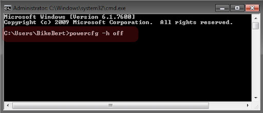

Disable Hibernate
Description: You may free up 1GB of space on the SSD if you have 1GB of memory, 2GB of space if you have 2GB memory. You will lose the hibernation feature which allows the equivalent of quick boots and shutdowns.
Instructions: Start Menu -> Type cmd -> Right-Click the cmd Icon -> Run as Administrator -> Type powercfg -h off -> Hit ENTER -> Type exit -> Hit ENTER
To enable type: powercfg -h on
